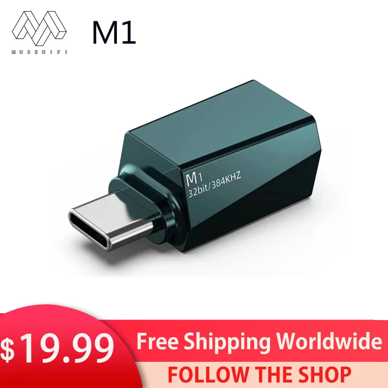

MUSEHIFI M1 Smart, $12.99
https://www.aliexpress.us/item/3256803429980061.htm
Was in a review where it did okay, and this is a amazing price for it. The power in port also looks like an aweome feature for smartphone use.
MUSEHIFI M1, $10.94
10.94US $ 20% OFF|Muse Hifi M1 Type-c To 3.5mm Decoding Amp/dac 384khz/32bit Audio Adapter Chip Apply To 7hz Timeless Dioko S12 Atom2 - Mp3 Players & Amplifier Accessories - AliExpress
Smarter Shopping, Better Living! Aliexpress.com
Was in a review where it did okay, and this is a amazing price for it. Tiniest offering I've found.
